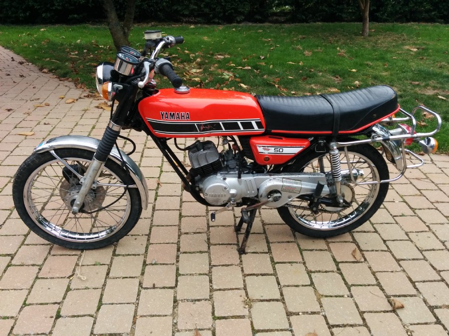

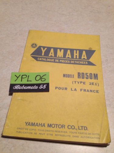

I forgot a very helpful detail. Try to find you one of those (yellow) Yamaha parts lists for your moped model. It is important that the list is for your specific model year! Otherwise you can't rely 100% that the part fits because Yamaha changed many things over the years.
Anyway, once you have the parts list, you will be able to search for parts with part numbers and not only by description. I am pretty sure that you will find way more parts if you use the part numbers.

Good morning Sir.
There were so many different model codes relating to Europe.
I'm certain mine is 2E1 (France)
I think this is the parts list you mention:
Thanks again MatTy :D<br /><br />-- 22.10.2017 10:50 --<br /><br />

Howdy! :)
yeah... that thingy will help you pretty much. Though you would have to become friends with french language... if that is ok !? Hehe :mrgreen:
The model codes are "just" numbers. More important is which parts are hidden behind these different codes. Especially when it comes to performance. Put the right parts together and you'll have a "gazelle" but if you randomly put the wrong parts together it will make you the ultimate snail racer. :wink:

On e-bay, there is an English version available but not the same model code??
I will send you the image and see what you think.

Hey Paufin,
okies... I thought so. hehe :lol:
The model code or model year should fit. So the french list would be the better choice for you.
As you can see, to own a model from another country doesn't make things easier.
